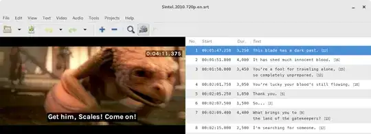

The solution you need here is gaupol . gaupol is a subtitle editing program that is also used to correct the wrong display of symbols.
First, you type in the terminal : file -bi my_subtitle_track.srt
so you can get the encoding of the file (may not work as expected everytime). You will get a result such as this
text/plain; charset=iso-8859-1
Then, after you have installed gaupol, launch it, and try to open the file using the encoding result you got above.If you see that the symbols display correctly, it means you opened it with the correct encoding, and now you need to save it as a universal encoding for compatibility with the other programs. Select File->Save As-> My_subs_track.srt with UTF-8 encoding.
Worked for me, hope this helps :)
