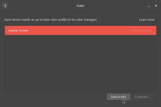

Maybe, Ubuntu cannot cannot recognize if your built-in screen is present or not. It generally happen with AMD Chipset laptop.
My laptop used to have this problem. You can fix this in the System Setting.
Setting > Color > Laptop Screen
If you see Laptop Screen Not Calibrated, then click on Add Profile.
Laptop Screen - Not Calibrated

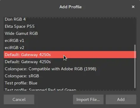

Select Default: Your Laptop Model (eg: my laptop Default: Gateway 4250s) then click Add.
Add Profile - Select Profile - Add
Then click on Set for all user.
Then Reboot. I expect it will boot up normally.
