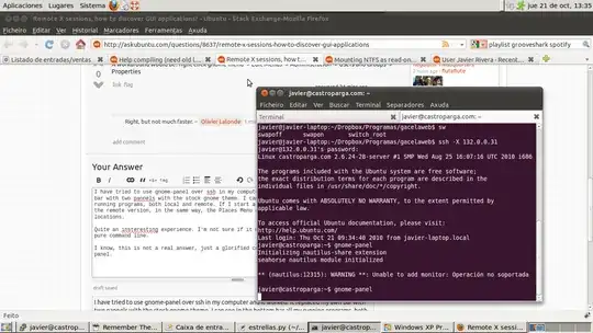

UPDATE: I just found out I could launch gnome-panel remotely. It does exactly what I need (the applications/places/system menus). The draw back is that it's messy because my local applications get mixed with the remote ones.
I have tried to use gnome-panel over ssh in my computer and it worked. It replaced my awn bar with two pannels with the stock gnome theme. I can see in the bottom bar all my running programs, both local and remote. If I start a program from the menu it launches the remote version, in the same way, the Places Menu also open remote nautilus in remote locations.
Quite an interesting experience. I'm not sure if it will be useful for me, too used to pure command line.
Interesting enough pressing "Print Screen" saves the screenshot in my local computer:
screenshot
I know, this is not a real answer, just a glorified comment. The answer will be use gnome-panel.
