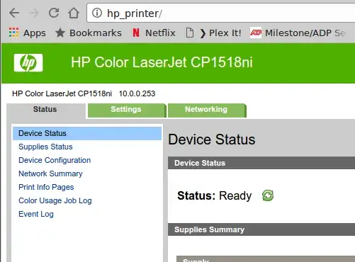

Now, I can also access the webpage for my printer setup at the name I gave it instead of the IP address which could be easier to remember:
