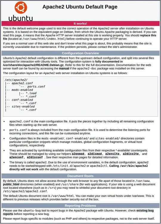

    • to confirm apache is up and running:
      • open your browser of choice and go to this address in the address bar: localhost/ and if it's installed you should see the image below

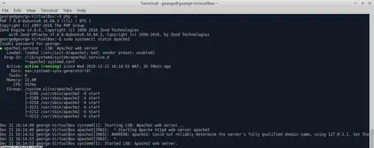

    • Run this sudo systemctl restart apache2 to restart apache so its incorporates php parsing functionality, then check if its running with the next step
    • sudo systemctl status apache2, you should see the image below if its running

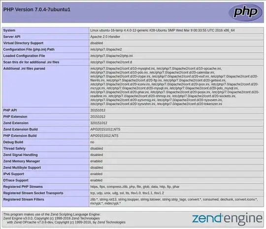

Now lets test your apache to see its working:
  • from terminal run: sudo vim /var/www/html/info.php, and put this in that file, or use nano if you prefer!
    <?php echo phpinfo(); ?>
Open a browser and put this [localhost/info.php] into your address bar and should see something like this:
