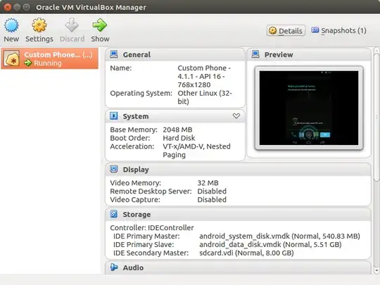

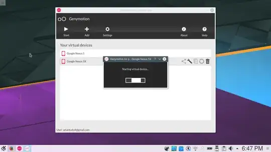

I'm on Kubuntu 16.10 and my problem is that all the virtual devices I create get stuck there forever. It works fine on Windows 10 so I don't know what's going on.
I've already tried opening it 100 times and reinstalling genymotion and the virtual device Also similar problem more details

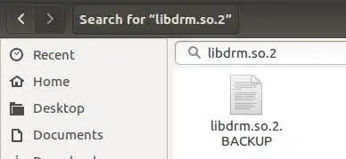

That can happen if your system has an ATI card.
Removing the libdrm.so.2 file from Genymotion directory or just rename like Rename file
then just hit genymotion to run and it should be fixed.
