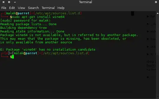

Please explain how I can install wine64

There is no longer a package called wine64 in the Ubuntu Repositories.
You can install a 64bit version of Wine like this:
sudo apt-get update
sudo apt-get upgrade
sudo apt-get install wine1.6-amd64
Be aware that there are many caveats with 64bit Wine. There are also a ton of bugs.
If you want the latest builds, you can install the WineHQ PPA:
sudo add-apt-repository ppa:wine/wine-builds
