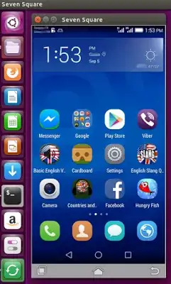

In that case, consider try SevenSquare. A tool used to view a mirror screen of your Android device on the PC, used for demostration, debuging, and so on. even you can click on the mirror screen as you touch on the device panel.

According to its GitHub page, SevenSquare has been reportedly working on both Linux and Windows system.
Installing SevenSquare
Make sure you have ADB (Android Debug Bridge) tools installed on your system in order to install SevenSquare:
sudo apt-get install android-tools-adb
SevenSquare based on QT, therefore you need to install these dependencies:
sudo apt-get install qt4-qmake libqt4-dev libqtcore4 libqtgui4
Now you can finally install SevenSquare:
wget https://github.com/yangh/sevensquare/archive/master.zip
unzip master.zip && cd sevensquare-master
make && sudo make install
Make sure you have enabled USB debugging on your android device, otherwise navigate to Settings > Developer Tools > and enable USB debugging, then connect your android device to computer via USB cable.
To launch SevenSquare, run following command:
seven-square &
Image taken from www.upubuntu.com
