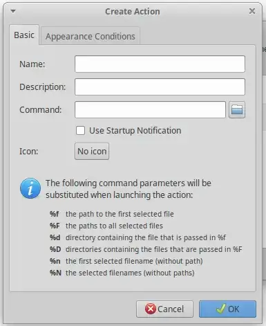

The only way I can think of doing this by creating a new "Custom action", which accepts scripts and binaries (in the "Command" option, below):

You can put whatever you want for the name and description, but here's the command part:
zenity --question --text="Are you sure you want to delete %F?" && rm -rf %F
It shows a dialog asking the user whether they want to delete the file(s) and if so, it deletes it. Also, if you just wanted to move the files to the trash, since Thunar already asks when you use Shift+Delete, then use this:
zenity --question --text="Are you sure you want to move %F to the trash?" && gio trash %F

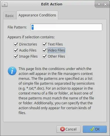

Lastly, be sure to click on the "Appearance Conditions" tab and check all the file types so that the action won't just appear on text files
