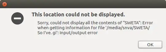

I recently deleted the Windows 10 from my HP Pavilion Laptop and installed Ubuntu 16.04.1 LTS using a pen drive. In another pen drive, I stored all the important data of Windows 10. But after installing Ubuntu, when I connected the USB to the port on my Laptop. It wasn't showing anything but the following window popped up.
Complete image of "Sorry, This location could not be displayed".
When I connected that pen-drive in another Ubuntu Laptop, I observed that many folders were converted into the binary files. However, I wasn't able to cut and paste those folders from pen drive to my desktop but was successful in copying a few of the folders. What should I do to get back my important data from USB?

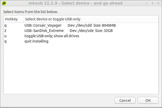

and mkusb will display information about all devices and later the possible target devices to let you select it via a menu, where additional data is displayed.
01-clone-a-device-overview
mkusb will filter the devices, and only show what are suitable target devices with numbers to help you select the correct one, in this example a Sandisk Extreme pendrive at /dev/sde
02-select-target-device

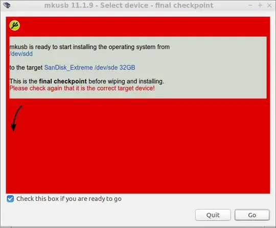

03-final-checkpoint
05-work-done
Check in the terminal window, that the whole device was read and all data written (cloned)!
