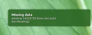

    If you close the targeted window, the indicator shows a message:

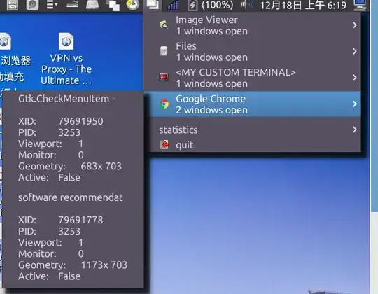

Using Unity's top panel indicator for information.
When writing my answer, I've realized that this would be a very useful feature to incorporate into one of my existing projects - the Ayatana Indicator. This indicator allows showing whole range of information about GUI windows. Currently is still under active development. The geometry info feature has been added to the github repository and is on the way into my personal PPA. And of course, it uses xwininfo although in slightly different manner.
