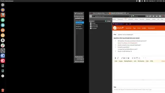

Everything but my background, terminal and right click menu works. However, I'm unable to see the terminal, but it opens. This all started when I recently updated my Ubuntu.
I have attempted to reset unity & the theme back to normal, however this did not resolve my issue.
