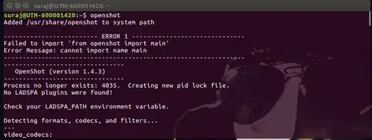

not able to run the openshot. Everytime, I run it it goes and create a process though. Even after ending process and restarting doesnot work, then running through terminal, gave me above mentioned error.[Above attached photo].
Many programs, including openshot, store user settings in your home directory.
These user configuration files are not removed when you remove programs including the use of the purge option. You have to remove them manually.
In this case
rm -rf ~/.openshot
openshot will re-create these files next time you start the program.
