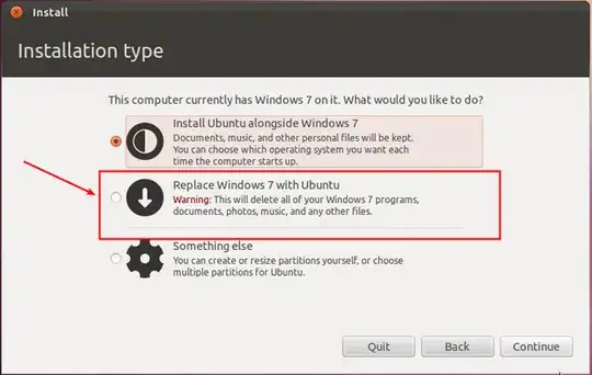

The Ubuntu installer easily lets you erase Windows and replace it with Ubuntu.
Here is what you have to do :
Backup your data ! All of your data will be wiped with your Windows installation so do not miss this step.
Create a bootable USB Ubuntu installation.
Boot the Ubuntu installation USB drive and choose erase everything and install Ubuntu.
Follow the installation process ... and at the step Installation Type select Replace Windows 10 with Ubuntu.
