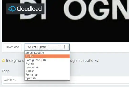

I have downloaded an avi with subtitles in multiple languages. I can watch the video online and choose the subtitle language I need.
However, I cannot see the subtitles with the Totem movie player nor with VLC.

So the commercial service you have used must be either:
  1. Loading a separate stream each time a different language is specified, this is unlikely.
  2. Loading an external subtitle file suitable for each specified language, more likely.

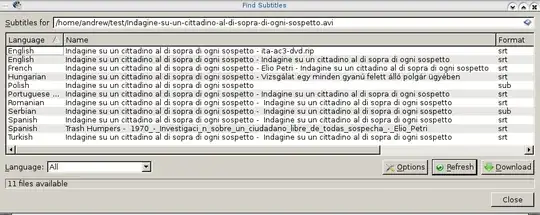

The good news is that you can download your own srt files, I did so from within the SMPlayer GUI by running:
Subtitles --> Find subtitles at OpenSubtitles.org...
and had quite a choice of subtitle languages available to me:

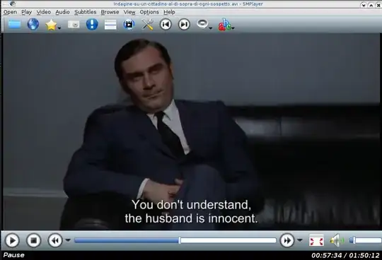

Simply select one the srt files, they will be downloaded and then easily viewed if placed in the same directory as your film. Below is an example with English subtitles:
And then all should be well... Not my taste in movies BTW :)
