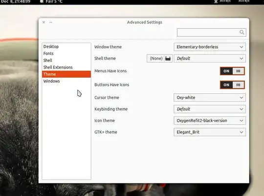

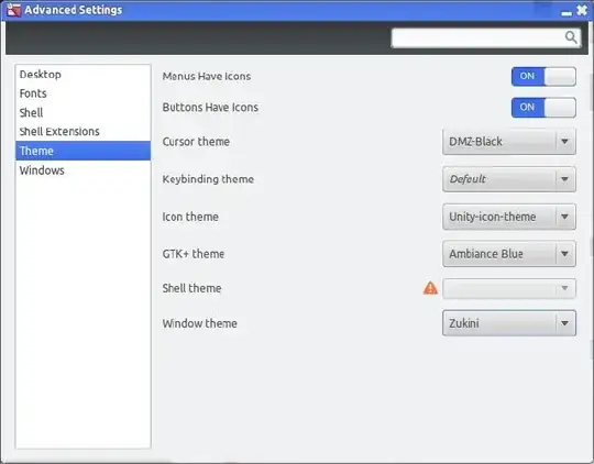

I don't know how I did it, but now I'm stuck with this same window theme! Whichever theme I change to, the window theme will stick and only the background colour of the window title will change.
Here I changed from Ambience Blue Theme to Zukini Theme but only the background colour of the windows title change from blue to greenish, the rest is still the same.
EDIT: Sorry I wasn't clear enough, I'm using Unity not Gnome3.

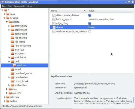

UPDATE: I tried to change with gconf-editor but it has failed to change the windows theme.
1.Window Theme selected in gconf-editor

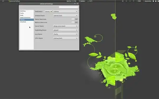

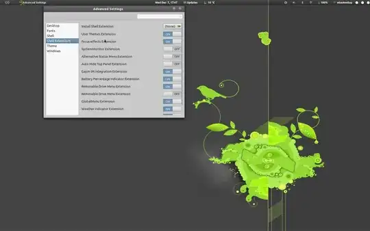

Assuming u have user-theme extension installed.
  1. U need to switch ON user-theme extension itself
  1. Once u switch it ON then logoff and login or Alt+F2 r.
  2. U should be able to see following menu: enter image description here
If you don't have user-theme extension installed itself then I advise you to follow: https://extensions.gnome.org/ or I had used http://www.webupd8.org/2011/10/official-gnome-shell-extensions.html

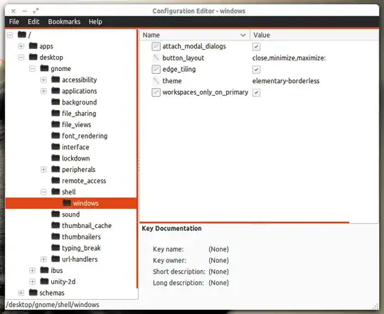

if this is not working, for some reason. try to go and open the gconf-editor.
hit alt+f2 and type gconf-editor. you will get this type of a window. enter image description here
then navigate to desktop > gnome > shell> windows. and change manually the theme there to another one. then log out and in, or reboot.
