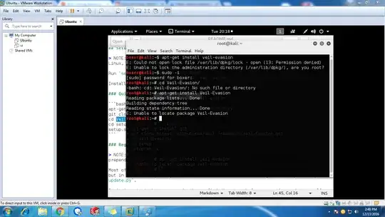

I have already downloaded veil-evasion but i can't install it
$ apt-get install veil-evasion
E: Could not open lock file /var/lib/dpkg/lock - open (13: Permission Denied)
E: Unable to lock the administration directory (/var/lib/dpkg), are you root?
$ sudo -i
# cd Veil-Evasion
-bash: cd: Veil-Evasion/: no such file or directory
# apt-get install Veil-Evasion
Reading package lists... Done
Building dependency tree
E: Unable to locate package Veil-Evasion
