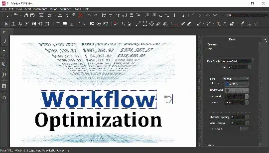

Master PDF Editor
Master PDF Editor is another program for editing PDF files in Linux. It enables you to create, edit, view, encrypt, sign and print interactive PDF documents.
It is a Proprietary Software but can also be used unregistered; further info on https://code-industry.net/free-pdf-editor/
Download on https://code-industry.net/free-pdf-editor/#get the newest deb package and install it or use
wget https://code-industry.net/public/master-pdf-editor-5.1.12_qt5.amd64.deb
sudo apt install ./master-pdf-editor-5.1.12_qt5.amd64.deb
