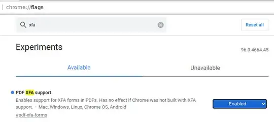

As of August 2021, Chrome 95+ also supports these files. However, to open them in Chrome, you'll need to go to chrome://flags, search for "xfa", and explicitly enable XFA support:
Screenshot
