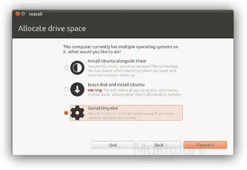

when installing Ubuntu in UEFI mode alongside Windows 10 I don't know what the partition table should look like. After this image:
what options will be presented? Assuming no recovery partition for Windows, just that the whole drive is partitioned for Windows 10 with GPT and UEFI.

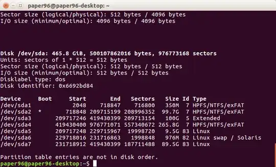

You can visit at WindowsDualBoot to find help on dual boot Ubuntu.
The partition table will look like
screen shot of partition table
