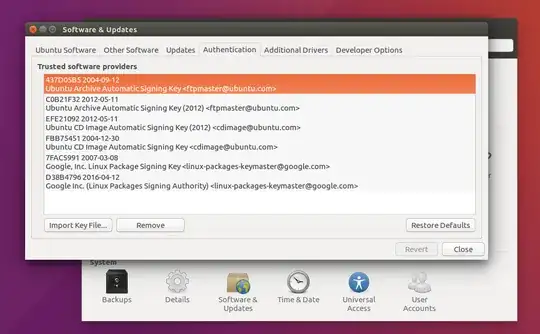

For some reason your keys are not validating your packages anymore. This can either be because the mirror you are downloading packages from is bad or your keys are bad. Since you already tried changing your mirror it's unlikely your mirror is bad, but instead you are likely missing keys somehow.
Go to the System Settings and open the Software and Updates then go to the Authentication tab. You should see some keys in there like the ones in this screenshot, if not hit the "Reset Defaults" button:
