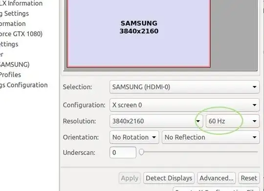

For anybody reading this with an Nvidia card, after my initial tests using the following hardware:
CPU: Intel 6700K
RAM: 64GB DDR4
VID: Nvidia 1080 GTX
SSD: 2x Samsung SSD 850 PRO 1TB (Raid 0)
TV: Samsung KS8500 4K
OS: Ubuntu 17.04 & 17.10
I had the same choppy lagging mouse movement. The solution was raising the refresh rate of the resolution. In my case it was in the Nvidia Settings. The video card had the Refresh Rate in AUTO (Which was setting it up as 30Hz). I changed it to 60Hz and that solved the issue.
The mouse now moves correctly and smooth.
