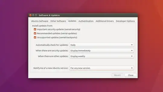

To upgrade to Ubuntu 16.10 from the current LTS you will need to tell the OS that you want to receive non-LTS updates.:
  1. Open ‘Software & Updates’ using the Unity Dash
  2. Select the ‘Updates‘ tab
  3. Find the section titled ‘Notify me of a new Ubuntu version‘
  4. Change this from ‘For long-term support versions’ to ‘For any new version‘
  5. Click ‘Close’
You’ll instantly be prompted to run a quick update.
