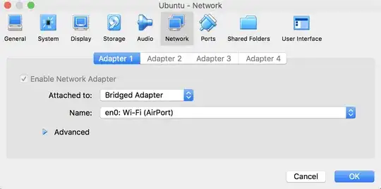

Interesting question : Do I have modify the network from VirtualBox of my VM of a certain way?
Given the IP, I would suspect the issue is the host machine doesnt know how to route traffic to 10.0.2.15? When initiating a SSH session from 10.0.2.15, the traffic is directed (routed) to the 192.168.102.x network by default.You can test this theory by trying to ping the 10.x.x.x machine from the 192.x.x.x machine, if it says something like network unreachable you have your answer.
In this instance a potential solution would be to amend the VM to have an address on the 192.x.x.x network, you should then be able to perform SSH from either machine.
I got the same problem earlier this week. The right way for you to use the ssh command on a virtual machine is to configure your virtual machine's network from VirtualBox as follows:
In fact, as @RichardRose and @TAtakaiWasumi pointed out, using ssh command on a VM needs to have an ip address similar to 192.168.x.x. I'm not an expert, but I read something related to this at a given time.
