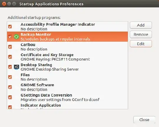

Disable Unneeded Startup Applications.
launch startup application by typing startup in dash and to disable a startup application, simply uncheck it.

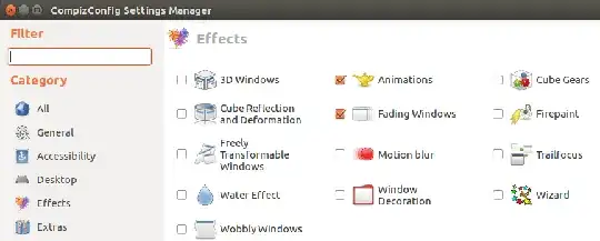

Disable Fancy Effects Use compizconfig-settings-manager to disable them
Install using
 sudo apt install compizconfig-settings-manager
and disable unwanted effects
