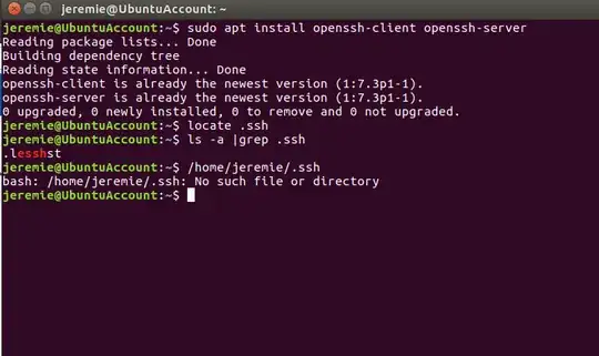

Check here for the .ssh directory in here /home/your-username/.ssh.
Its hidden as a result of the dot(.) before the name.
So to find it do ls -a | grep .ssh in your current location as seen in the image. Also try using nautilus
