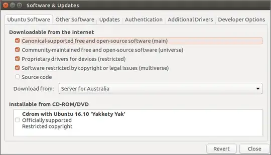

I just freshly installed the latest Ubuntu and I have a few problems:
Packages such as Skype won't show after selecting Canonical packages
Software & Updates menu:

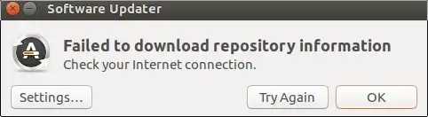

Once I select them and close, it complains they are out of date and it needs to be updated. I authorise and let it do it's thing but it brings me to this:

Skype not being shown in Ubuntu Software is a known issue. You can install it from terminal instead:
sudo apt install skype
As regards the other message, it's probably what it says. You may want to open Software & Updates and try another download server.
