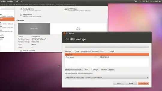

I am having this issue with 11.10 . Ubiquity doesn't detect the existing windows 7 partition and when I choose to manually partition the disk, I can't see any partition there. When I log into the live system and open Disk Utility, It shows my HDD partitions fine but Ubiquity for some reason is unable to detect them. Can't install 11.10 'cause of this issue :( I tried installing 12.04 Alpha 1 and the issue still persists.

Screenshot: Disk Utility can detect the NTFS partition but ubiquity doesn't.
It looks like this disk used to use GPT, but then you used a non GPT aware tool to redo the msdos partition table, so now the system isn't sure which partition table it should be using. You will need to remove the broken GPT to properly go back to using the msdos table, which you can do with the gdisk utility.
