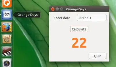

And just for fun...
A tiny application. Add it to a shortcut if you use it often.

  • Copy it into an empty file, save it as orangedays.py
  • Run it:
    python3 /path/to/orangedays.py
