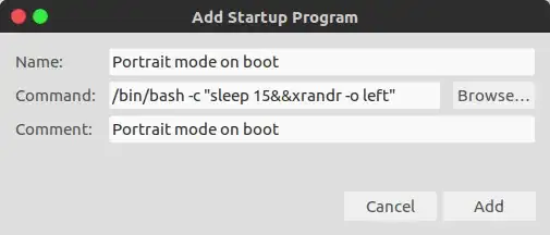

Add following to startup application :
/bin/bash -c "sleep 15&&xrandr -o left"
The reason adding 15 second of break to prevent xrandr command performed too early, which cause desktop to break while the desktop is still loading. @Jacob Vlijm explain why this is necessary.
