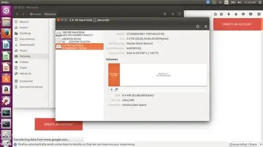

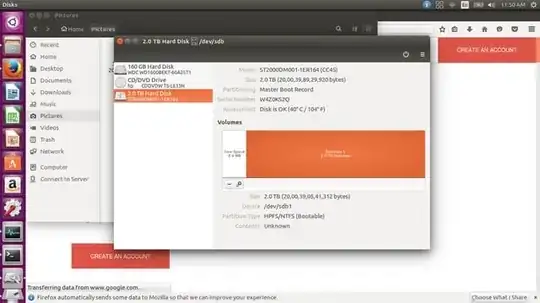

I am new to Ubuntu. I've just loaded Ubuntu 16.04 and I'm unable to access my external HDD.
screen shot screen shot .

$ sudo mount -t ntfs-3g /dev/sdb1/media/bal007
mount: can't find /dev/sdb1/media/bal007 in /etc/fstab
this external HDD was working fine with Windows 7 earlier
Zanna
  • 72,312
You are missing a space between /dev/sdb1 and /media/bal007. The hint is in the message displayed by mount: can't find /dev/sdb1/media/bal007 in /etc/fstab.
