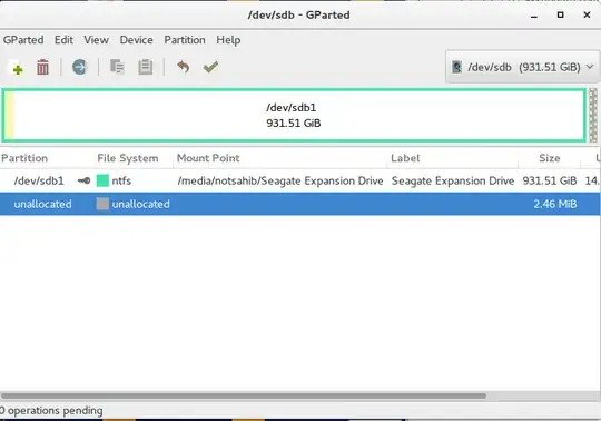

I have a Seagate Expansion Portable 1TB external drive, and I am planning to install Ubuntu on it.
However, the disk seems to be MBR, and not GPT, which seems to be an issue, as my computer has a UEFI motherboard.
It looks like this in GParted:
Drive in GParted

I've seem to figured it out.
