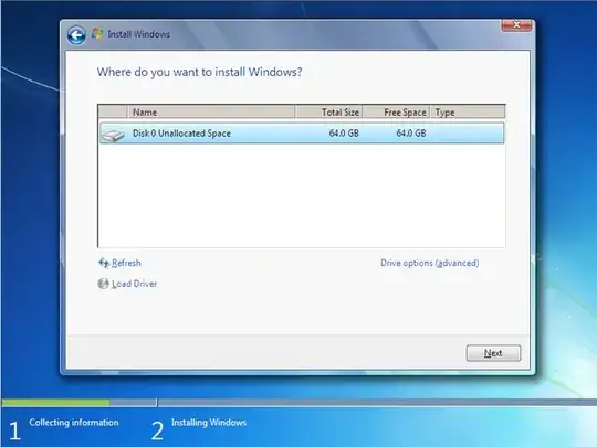

For that purpose you will find a screen like this:

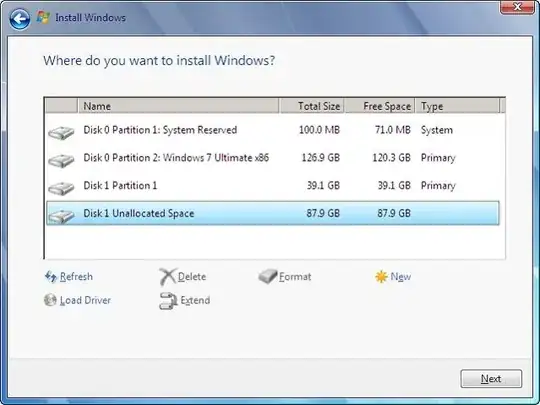

On which you can click on the "Drive options (advanced)" link in order to see this:
Note that both images are from different sources, the last one shows you several partitions, which can be erased by using the tools provided.

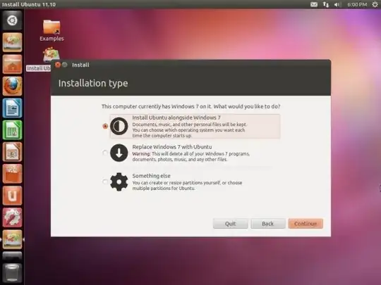

You may wish to look for an install step-by-step process/manual for Windows 7 if that's what you wish. Take in consideration that if you wish to install Ubuntu again, you will have several options in the partitioner when installing, which includes but not limits to "Use the entire disk", as shown in this partitioning tool screenshot:
