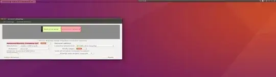

Here is an image of my desktop after trying to add a second separate monitor:
desktop
I'm not sure whether this comes down to the drivers or the system config.

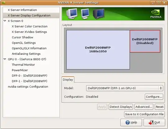

Press Ctrl+Alt+T to go to a terminal and type:
nvidia-settings
then you'll see something like this screen: nVidia xserver settings
From the left pane,
  • choose X Server Display Configuration
  • click the secondary screen in the dialog window
  • click Configure.
  • Enable TwinView.
If it doesn't work immediately, reboot the computer.

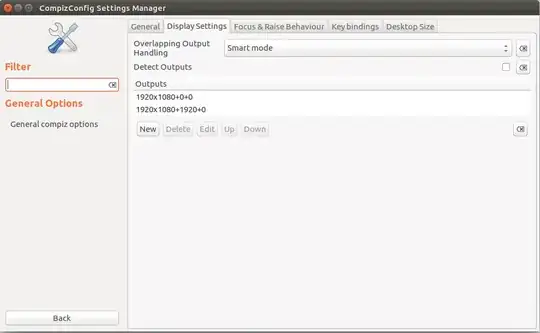

I had the same problem and I solved using compizconfig. In General Options → Display Settings disable Detect Outputs and set the outputs format.
