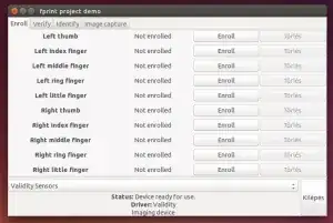

Finally, enroll a finger
sudo /etc/init.d/vcsFPServiceDaemon start
sudo fprint_demo
This pop-up should appear
thumbnail
Enroll your right index finger.
You should now be good to go
