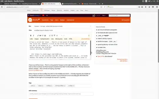

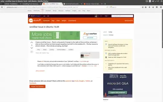

I have a scroll bar issue. There's a tiny pixel of margin to the right of the scroll bar, whenever I click on the scrollbar (on that margin) anywhere but not in the middle of it. The bar moves to where I clicked This is kinda annoying, any help?
Cursor Scrollbar Issue
When I hover on the scrollbar but not in the middle and click it. It kinda magnets the middle of the scrollbar to where I've clicked, another issue is that the cursor actually goes beyond the scrollbar to the right of it (a margin of around 1~2 pixels).
Scrollbar Right Margin
In this picture, I'm pointing to the right of the scrollbar, actually inside the scrollbar section. But the scrollbar is not in hover-mode However, when I click in that exact location the scrollbar scrolls to that location.
What I need to do is to remove that 1~2 pixels or margin, and turn off that scroll bar magnet problem so that when I click on any point on that seeker it doesn't scroll to the middle automatically.
