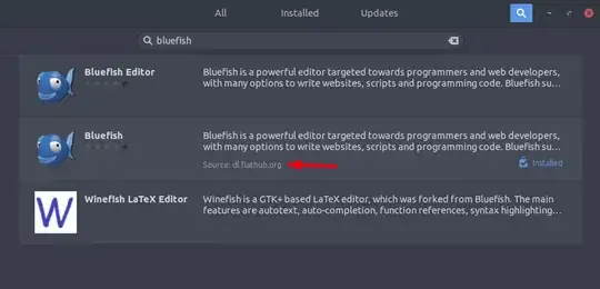

The klaus-vormweg PPA is no longer resolving, so to get the newest version, I had to add flatpaks to Software Center:
sudo apt install flatpak gnome-software-plugin-flatpak gnome-software
flatpak remote-add --if-not-exists flathub https://flathub.org/repo/flathub.flatpakrepo
Then restart your computer, log in, and search for Bluefish in the Software Center and install the flatpak version (see arrow below):
At this time of this writing, the flatpak was on version 2.2.12, and the Ubuntu Bionic Universe repo was on version 2.2.10.
