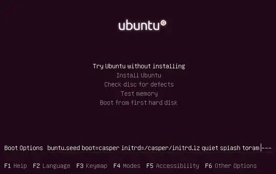

A. When you boot with syslinux you can add boot options like this:
  1. As the CD boots, the user can gain access to the advanced page and its options by pressing any key when the small logo appears at the bottom of your screen.
  2. After selecting language you arrive at the main menu of the installer.
  3. Select 'Try Ubuntu without installing'
  4. Press F6.
  5. A menu with a number of options appears. The option toram is not there, so press Escape to close the list.
  6. Now a string of options is visible, often with 'quiet' or 'quiet splash ---' at the end. Add toram to the string surrounded by spaces before the dashes.
    ... toram ---
  7. Press return, and booting the live session 'Try Ubuntu' continues ...
See this link for more details, Syslinux boot options

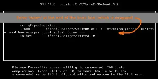

B. When you boot with grub you can add boot options like this:
When a live drive boots to grub, you will see the grub menu (white text on black background). 'Try Ubuntu without installing' is selected, and should be used in this case.
  1. The automatic countdown may be stopped by pressing any key other than the ENTER key.
  2. Press the 'e' key to reveal the selection's settings.
  3. Use the UP/DN/Left/Right cursor keys to navigate to the desired point for editing. Do not use ENTER to move between lines.
  4. Move the cursor to the space before the dashes at the end of the 'linux' line. Add toram to the line surrounded by spaces before the dashes.
    ... toram ---
  5. When editing is complete, Press CTRL-x or F10 - and booting continues.
See this link for more details, Editing the GRUB 2 Menu During Boot
