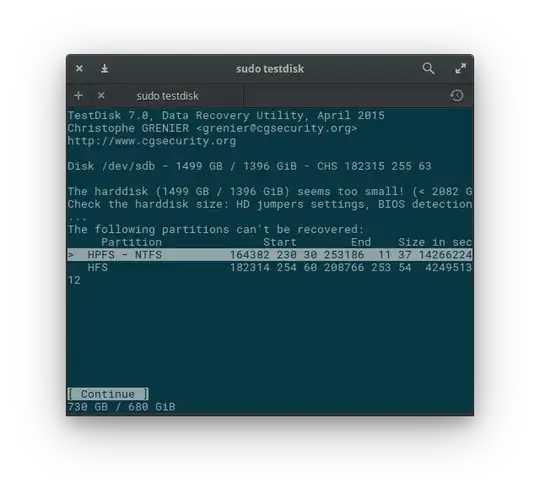

I followed: Recover 1TB disk erased with startup disk creator, which showed a list of partitions not able to be recovered, and some which could be. From the partitions of which I could list files, none were my data partition. There were two partitions of identical size (about 200GB) which I could not list the files of. I know the 'label'/name of my data partition, if only I could search for it.

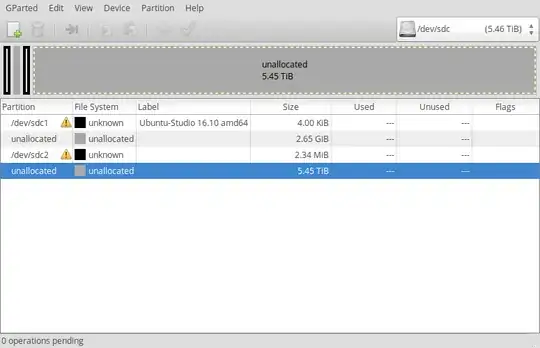

GParted screenshot
To my knowledge my HDD is not 5.45 TiB, it is ~1.5 TB.
Any method which repairs the partition records in place is ideal, I do not have a separate external HDD for backing up my files.
Update: this is what I see:
Testdisk output 1

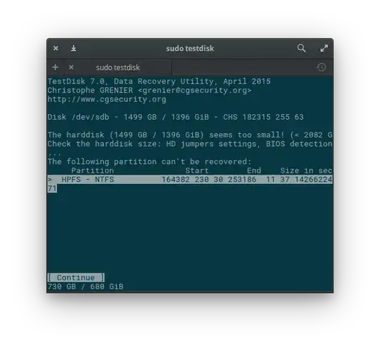

Update:
Testdisk output 2
Scan has finished, I would like to attempt to Add Partition using data from the screenshots, can someone please confirm my actions?
I do not have an external HDD and am attempting repair in-place, with testdisk if possible. Searching for 'testdisk add partition' is returning few relevant results, e. g., https://ubuntuforums.org/archive/index.php/t-797449.html
I am trying to get specific advice about recovering the partition layout, or recreating it if it's corrupt beyond repair.

Gparted is not able to interpret the partition structure of the cloned iso file correctly - this is why the drive size seems to be 4 times bigger than it is.
