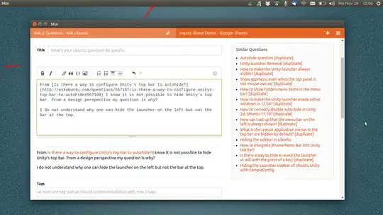

From Is there a way to configure Unity's top bar to autohide? I know it is not possible to hide Unity's top bar. From a design perspective my question is why?
I do not understand why one can hide the launcher on the left but not the bar at the top.
