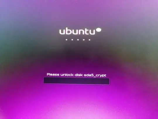

This is the disk unlock splash screen (NOTE: This used to show dots for each character typed. Now it doesn't respond to keyboard actions and it does not record a password when typed, even without the echo). Ubuntu disk decrypt splash screen

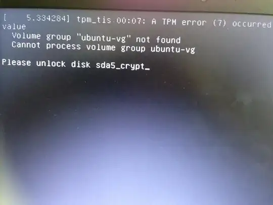

When I select "Ubuntu" to boot normally, I am presented with the following errors and a prompt to enter the disk decrypt password (which now works). The TPM error is followed by "unable to read pcr value". Ubuntu disk unlock in GRUB

I had the same issue after installing proprietary NVIDIA GPU driver. Disabling splash screen worked for me. I know this is not a complete solution, but I think this workaround might be helpful because it is better than using GRUB menu options on every system boot.
I edited /etc/default/grub file: removed quiet splash from the GRUB_CMDLINE_LINUX_DEFAULT parameter. Then run sudo update-grub. Now the splash screen is gone and and I see a prompt to enter disk encryption as on the last screenshot in the question.

It's normal for password requests not to echo back anything as you type, so some nearby onlooker can't see your password. Continue typing your known password, and if it's the correct password, it'll let you pass.
For now you can ignore the TPM error, at this point it's probably just noise from the Trusted Platform Module software. Later, we may decide to reinstall the TPM software if problems still exist.
I'd be concerned about the not being able to find/read "ubuntu-vg" error message. The first thing I'd do is a fsck (file system check) on your boot device. I normally have a predefined script on how to do this, but I'm not familiar with troubleshooting LVM disks, so I'm going to give you a modified process that should do the same job...
  • boot to the GRUB screen
  • choose Advanced Options
  • choose to run the fsck process
Report back.
