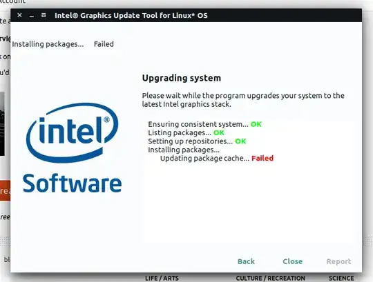

I'm having trouble updating Intel drivers with the Intel Graphics Update Tool v2.0.3.

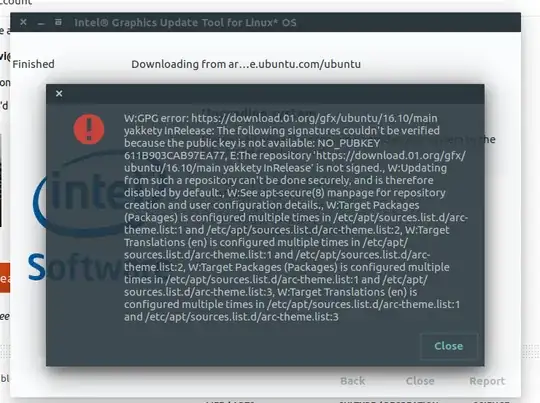

And this is the error window:
I'm using an XPS 13 FHD with an i5-6200U and IntelĀ® HD Graphics 520 (Skylake GT2), running Ubuntu 16.10.

The repository for the Intel Graphics Installer for Linux requires a gpg public key. From https://01.org/linuxgraphics/downloads/intel-graphics-update-tool-linux-os-v2.0.3, we see that we need to add this gpg public key. Enter the following commands in terminal...
wget --no-check-certificate https://download.01.org/gfx/RPM-GPG-GROUP-KEY-ilg
sudo apt-key add RPM-GPG-GROUP-KEY-ilg
To solve the lists defined multiple times, again, in terminal...
ls -al /etc/apt/sources.list.d/arc-theme.list*
You'll probably see something like this:
arc-theme.list
arc-theme.list:1
arc-theme.list:2
arc-theme.list:3
We want to delete all but the first one:
sudo rm /etc/apt/sources.list.d/arc-theme.list:1
sudo rm /etc/apt/sources.list.d/arc-theme.list:2
sudo rm /etc/apt/sources.list.d/arc-theme.list:3
