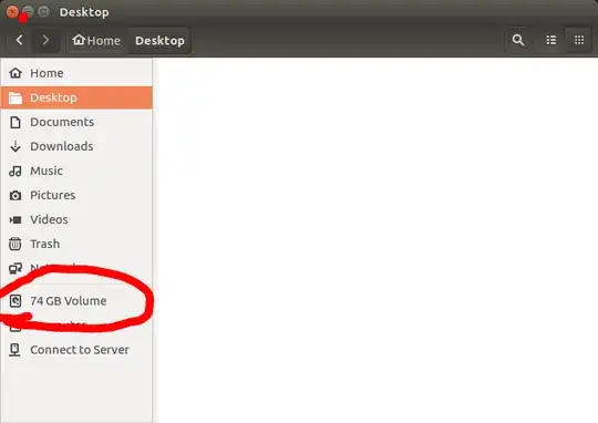

Open the File Browser and you should see the drive listed in the left menu:
Once you click it the drive will mount. It works for NTFS drives out of the box you don't need to install anything.
The only reason I can think it wouldn't work is if your NTFS drive has been marked as "needs to be checked" by Windows, which is a bit more complex of an issue. You can fix that by booting into windows or running the ntfsfix command (see this question).
