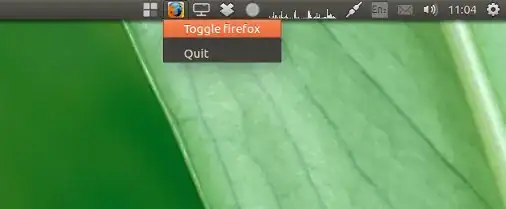

The solution below will allow you to run firefox (or any other application) in the background, meaning: without a visible window. Nor will the application show in Dash as a running application:

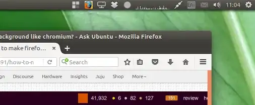

If you pick Toggle Firefox however, the application will pop up immediately:
How it works
  1. If the panel icon (indicator) starts up, it launches a new firefox window, but immediately hides it (including possible existing firefox windows) from the face of the earth, using xdotool:
    xdotool windowunmap <window_id>
    This will not only hide the window, but also will hide the fact that firefox is running at all, since the unity launcher acts on visibly existing windows.
  2. The indicator stores the id of all unmapped windows in ~/.config/hidden_windows, to be mapped on the next time you choose Toggle Firefox from the menu.

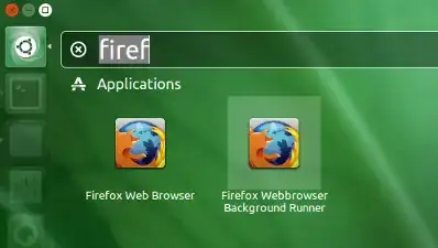

    Then you will have the panel runner available from Dash:
