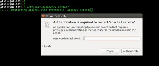

I am normal user with sudo privileges. I just installed apache2 and when tried to restart the service, it asked for the password of another sudo user in the system.
I can restart like sudo /etc/init.d/apache2 restart. But why it is behaving like this?

Is it related to apache2 or sudo user ? Please let me know if more details needed.
