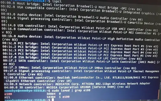

lspci shows that Ethernet card is connected. lsmod | grep e100 shows that e100 module is loaded (See below picture): enter image description here

You installed Ubuntu package r8168-dkms and that changed alias ID's to keep the r8169 driver from loading. You should be able to fix by executing the following command in terminal
sudo apt-get remove r8168-dkms
Reboot
