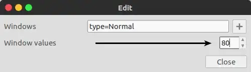

NOTE: For those who interested on getting transparent window, you might want to install Compiz Settings and its plugins:
sudo apt install compizconfig-settings-manager compiz-plugins
  1. Press Alt + F2, type ccsm on field to launch Compiz Setting.

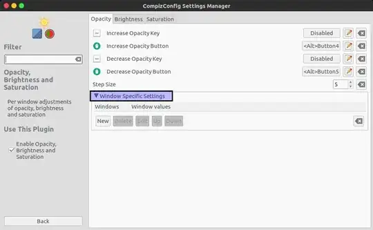

  2. On Accessibility section, click Opacity Brightness & Saturation plugin.
  3. On the current tab, expand Window Specific Settings.

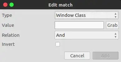

  1. Click New button, then click + and Edit Match window will be appear.

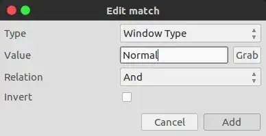

  1. On Type field, change value from "Window Class" to "Window Type". Then type "Normal" on Value field. Don't forget to click Add when you're done.

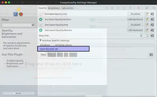

  1. Back to edit window, you have to set your preferred opacity values, you can set the values from 0 to 100. Less values make the window more transparent, we'll use 80 for example.
  1. Click Close then, as you can see there are new defined specific settings.

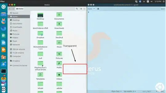

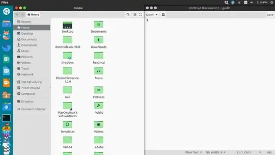

Before effect
After effect

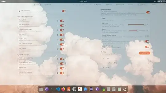

I managed to achieve global window transparency in Ubuntu 24.04 without using compiz or xprop solely by installing the Blur my Shell extension via the GNOME Extension Manager. In the Blur my Shell settings, go to the Applications tab, set Application blur with an Opacity value lower than 255 (to your taste).
My desktop with transparency 155:
my desktop with transparency 155
