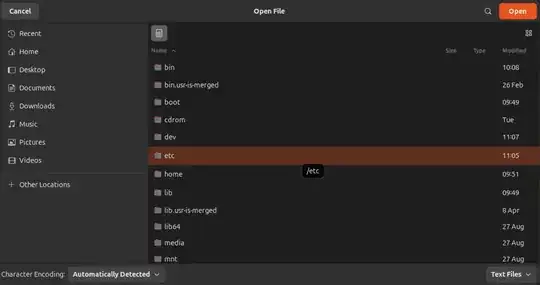

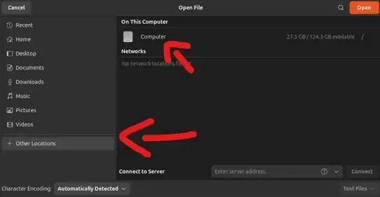

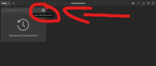

Here's a super simple answer for people new to Linux:
  1. Open the default Text Editor. You can find it by searching for "Text Editor": Ubuntu Search for "Text Editor"
  2. Open New Document: Open New Document
  3. Go to "Other Locations" and choose "Computer": Other Locations
  4. Navigate to etc folder: etc folder
  5. Choose the sudoers file
  6. Find the line that says %sudo ALL=(ALL) ALL or %sudo ALL=(ALL:ALL) ALL
  7. Change it to %sudo ALL=(ALL) NOPASSWD:ALL or %sudo ALL=(ALL:ALL) NOPASSWD:ALL
