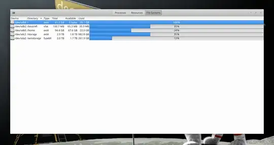

I'm running Xubuntu 16.04 LTS, and I have a ~40 GB root partition which is 100% full according to System Monitor (as root). It's definitely full, since many programs aren't functioning correctly.
System Monitor Disk Usage

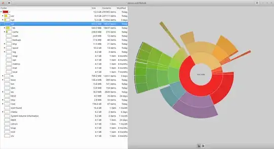

However, for some reason, I can't seem to figure out what is using the space! Baobab (as root) only reports a total of 15.5 GB used on my root partition!
Baobab Disk Usage

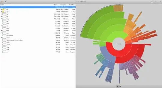

EDIT: Also, here's /var - people said that it's big. Baobab only reports 1 GB for /var, and /var/log is empty. I've tried running sudo rm -R /var/log and there was no effect.
