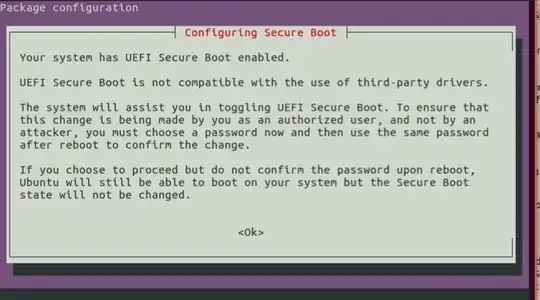

Setting up shim-signed (1.19~16.04.1+0.8-0ubuntu2) ...
E: Sub-process /usr/bin/dpkg returned an error code (1)
secure boot
Sss
